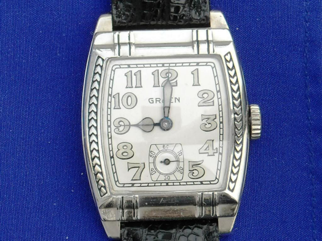

One of the few deals I think I got on eBay and my first solid gold watch (Damn you, Roger!!):
It was up for a bit as a BIN/offer with not too great a pic before Holben listed this one recently:
Holben's pic sold me on the other! I made a great deal with the gent who had owned it for over 30 years and paid significantly less than I would have had I gotten the one from Holben.
I would like to get the enameled numerals restored as in Holben's pic, though, so my questions:
1) If I have the enameling done and it turns out to be sloppy work, can it be removed with no harm to the watch?
2) Do watchmakers do this enamel work themselves or do they send it out?
3) I have read some threads here about doing this sort of work oneself with an enamel paint pen, for instance. If I mess up, can it be removed easily?
(Holben's was a redial, not sure if his or mine is "correct". The guy who owned mine had not had it redone. . . )
