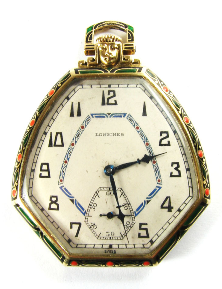

I know its not a gruen but this case has similarities..the colored enamel notably the red/orange balls and of course the head. This serial # for this watch is 3994527 dates it to 1921. This is a swiss cased longines and the serial # is on both movement and case. Longines movement # dating is not perfect but is accurate enough to give you ballpark figure. My opinion is that the gruen is from the same time period as this watch.

SFC wrote:I know its not a gruen but this case has similarities..the colored enamel notably the red/orange balls and of course the head. This serial # for this watch is 3994527 dates it to 1921. This is a swiss cased longines and the serial # is on both movement and case. Longines movement # dating is not perfect but is accurate enough to give you ballpark figure. My opinion is that the gruen is from the same time period as this watch.
The case maybe so, but I don't agree with dating the movement to 1921. The UV caliber was only introduced by Gruen in 1922 as Barney already said.
