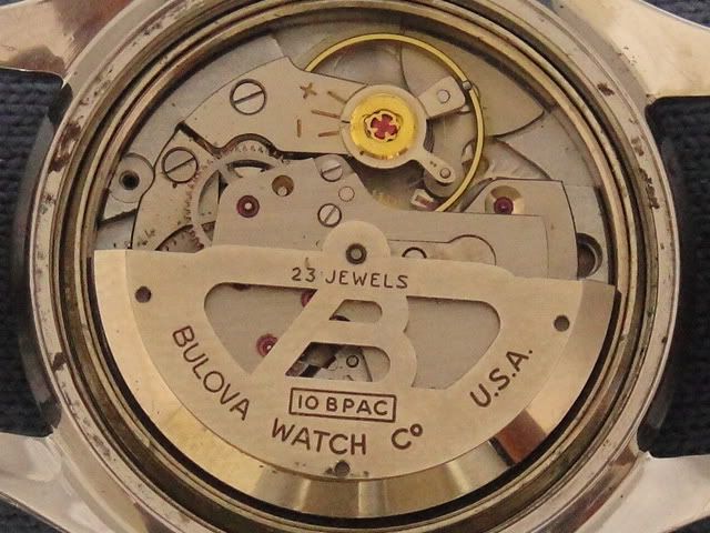

Here is a nice 1955 made in USA Bulova Calendar Automatic, 23 Jewels (10BPAD)
NOTICE the 'B' insignia engraved on the rotor:
One of my early aquisitions

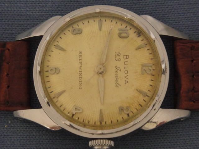

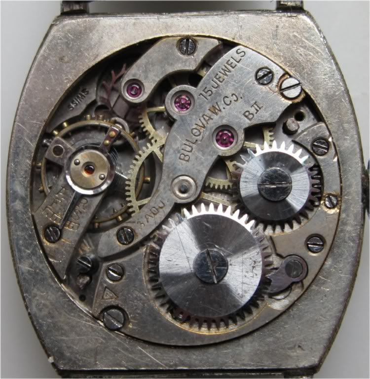

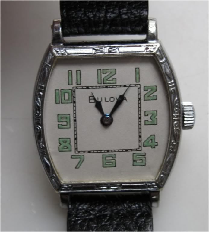

An interesting thread and very educational. I only have a handful of Bulova's and I have one that is a bit of an anomaly (to be sure). I don't even remember where I got it, but it has a hideous refinished dial (see my "minty" post in the Hamilton forum), no sub-seconds dial and the movement is marked Swiss and BII - 3 adj. Not being an expert (not much more than novice) in these things I just thought I would show it.
This is an old favorite - I think ca 1959 - 23 jewels, self winding with a nice patina on the dial and a cool scalloped bezel.

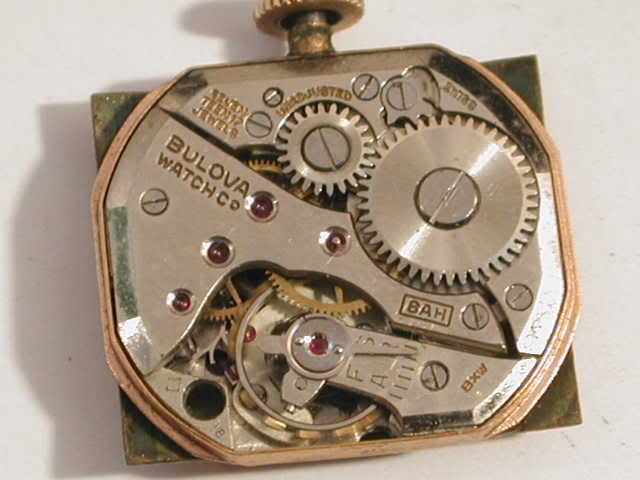

Edit - one more - this one is rose or coral gold filled (not sure what year - 40's?) and the movement is marked 8AH and below that BXW (which appears to pertain to an import code for Swiss watches - link here http://www.mybulova.com/node/3953 ). Have never seen that before.

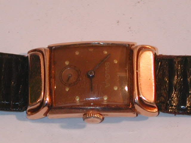

#5 Post by GeneJockey » Wed Feb 22, 2012 7:25 am
That's a 'Squadron', from 1946. See the little square on that raised area near the balance? That's a date mark. The square indicates the year within a particular decade, and in this case '6' in the 1940s.
A few years later, Bulova went with the letter/number code. They started with 'A' for the 1940s, but then 'L' for the 50s and continued serially through the alphabet.

#6 Post by daxtellgt6 » Wed Feb 22, 2012 11:39 am
I thought it was 1946, but in looking at the reference I saved there seemed to be numerous years where they used the same (or similar) square mark to denote the year code. Thanks for identifying it - Squadron is cooler than "rose gold thing with hooded lugs" :lol:
