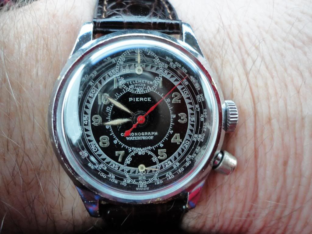

#26 Post by indyago » Sat Jan 11, 2014 7:39 pm
Keeping this thread alive! ;)
Recently picked up this Pierce one button chronograph with black dial. It was running but, the chrono function needed the normal repair. Due to Rick's and Mark's, (aka. Old Lyme), help and sharing their repair person, I was able to get this one put back to running. These are very cool watches to look at, operate and wear! This one has some case wear but, it all just adds to the vintage look. The dial is very crisp through the new crystal and the refinished chrono hand adds a nice contrast to the black dial and chrome plated case. It has been getting plenty of wear this week!
