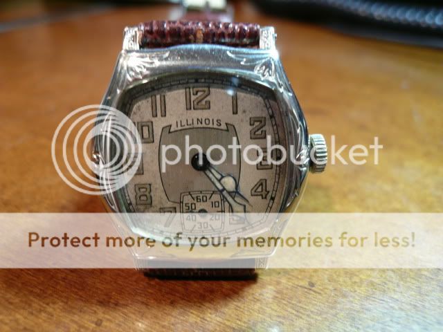

I recently picked up an excellent condition Illinois speedway, a model I have been wanting to add to the collection for some time now. The seller shed some light on the watch after I purchased it. His father likely bought it brand new back in 1929 when he was 21 years old, having been born in 1908. The father owned his own dairy business which would have given him the monetary gains to have purchased this fine watch from the Illinois watch company back then. Does anybody know what the speedway retailed for when it was introduced on the market? Is there an original advertisement detailing this watch here on the forum?
From my understanding there are two variations of the Speedway in terms of case design. One being the bezel design pictured and the other with vertical bars. From what I hear, the design pictured is more desirable, could be personal opinion though.
Overall analysis of this watch would indicate little to no case wear. Very minor wear is present on one of the lugs. Genuine Illinois hands are present, missing the second hand though. The dial is interesting. While being a genuine Illinois dial, I have never seen this dial variation on a speedway before. I am aware of the radium dials that were and still are on many models and that the exploding radium dials are the most sought after now. I originally wanted to put an original exploding dial on this watch for restoration, but since learning the history behind this piece, I might leave this original dial on it as it's in excellent original condition.
I have a genuine replacement second hand but will need to start searching for a replacement crystal as the one on it currently is plastic, no good. On top of the minor cosmetics that are needed I will be restoring the movement with a partial disassembly, balance/train cleaning and lubricating with the help of my mentor.
I am wanting to document this cosmetic/mechanical restoration here on the forum from start to finish for any who are interested. The watch does not run, the mainspring is wound tight. The train is locked up as the escape wheel does not engage when the pallet fork moves as I give the watch a gentle rock. Tomorrow I will access the movement and we shall see what lies inside.

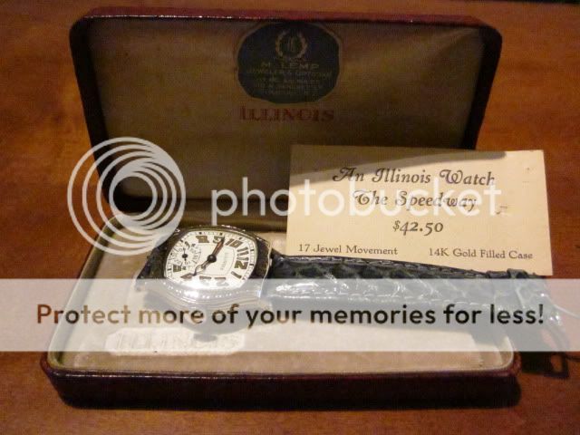

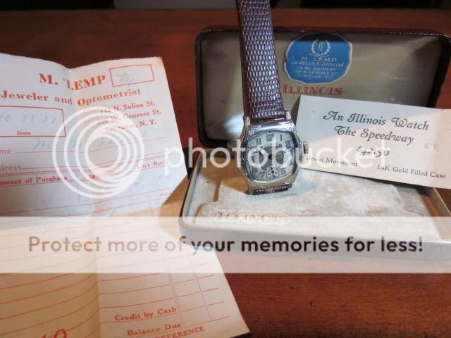

As for the retail price. I found a 1930 Factory ad. that stated the " Speedway " sold for $42.50, with a 17 jewel movement in a white gold filled case and strap band.

Congrats on a SUPER Speedway. There is SO much to learn when it comes to Illinois watches,
and just when you think you have discovered it all... BANG, you discover something new.
Anyway,
The first thing you should do is get Fred Friedberg's book on Illinois.
It is available and it has incredible information inside.
This forum has the greatest concentration of Illinois collectors anywhere,
so you are bound to have some fun here and learn a thing or 2.
My first question is... do you have a good watchmaker who knows this brand?
There are folks here who can recommend a good person.
The Speedway you have has an interesting dial that I have seen on very few examples.
Not sure if it is original or not, but it could be a Hamilton owned era replacement dial.
Don't get rid of it or have it redialed. It is cool for now.
There are several "Speedway" models with the Model 178 designation.
Some examples were given to drivers of the INDY 500 "Speedway"
The pattern like yours with the floral pattern is more common and the "Checkerboard"
seen a bit less. IMO.
This is the most common dial.
Keep that band OFF of it!!!
It is NOT original and will only harm the lugs by having metal rubbing against those beautiful engraved lugs.

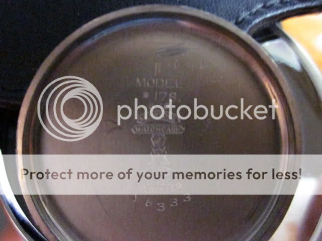

I was able to open up the watch case recently and found a few interesting discoveries, nothing too alarming yet! The watch is heavily corroded with dust and contaminants to the point it would seem this watch was put away when it quit working decades ago. I know the watch had been worked on at least once in the past, but don't know when. Removing the pristine condition bezel reveled a pristine aged Illinois dial. The material you see between the 4 and 5 position is dirt. I might try rolling Rodico over the dial after all the dust and dirt has been removed. I am thinking the yellowing is from nicotine, could be from age though. I have to be super carful to not hurt the dial either way. I have three second hands to choose from for replacements so we are good in that area. The crystal is plastic and needs to go, I will be sending off measurements to Veritas123 soon and hope to locate a genuine replacement soon. Upon further investigation looking at the fourth wheel pivot that holds the second hand, I noticed the pivot might be broken to some degree. Will need further investigation down the road on this issue.
The movement is a genuine Illinois 17 jewel single roller movement. Serial number dates the movement to the year 1930. If the Speedway came out in 1929, could this be a later variation? Perhaps the dial could further compliment this idea? How many years was the Speedway produced? I understand Hamilton took ownership of the company during this time period.
Currently the watch will not run. Although the balance and pallet fork are free, the train of the watch will not move under it's own power and the fourth wheel will not move at all when the impulse jewels move back and forth. We will perform a full cleaning and oiling of the watch later. Rust is present on the case screw above the serial number as well as one dial foot screw. Both case screws were extracted very carefully. Rust is also present on the stem key slot on the movement, stem, and stem sleeve. Not a good sign!
The case back shows this being a genuine model 178 case which would be correct for this model. Several repair numbers have been inscribed on the inside area of the case back as you can see in the last picture.
