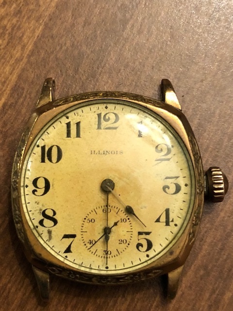

I found this Illinois in one of my "will work on later" drawers.
I'm curious if the watch is correct as according to the serial number it would date to 1907. Is the movement original to the case?

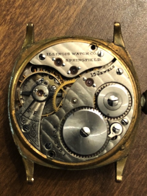

This movement would originally have been in a hunter-style pocket watch case. At some later date someone, probably a jeweler, transferred it to a generic wristwatch case as pocket watches fell out of style. Although only the movement is by Illinois, such "updated" watches were popular in the late 1920s and early 1930s.

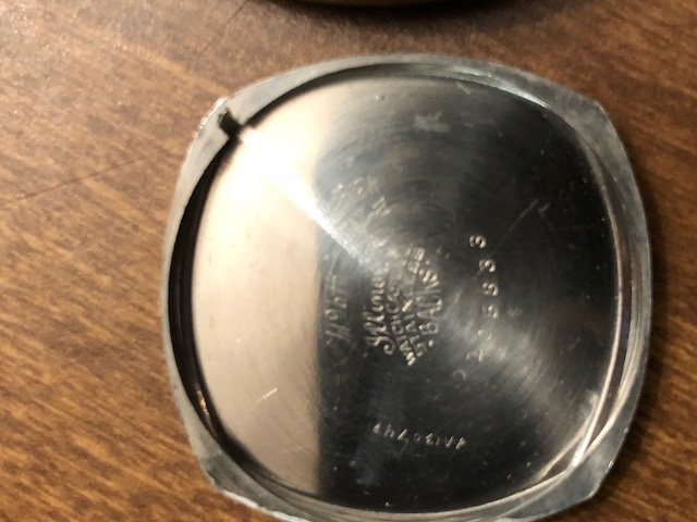

That is the conclusion I had come to. It threw me some when I saw it was an Illinois case also.
An interesting piece. Shows how innovative watchmakers were with changing times.

A lot of people get thrown off because of the Illinois name. It's easy to do if you aren't aware that the Illinois Watch Case Company (Elgin, Illinois) and the Illinois Watch Company (Springfield, Illinois) were entirely different companies and that the latter didn't make cases.

Only thing I can add, is the stainless steel marking in the case puts it into 1930s.
