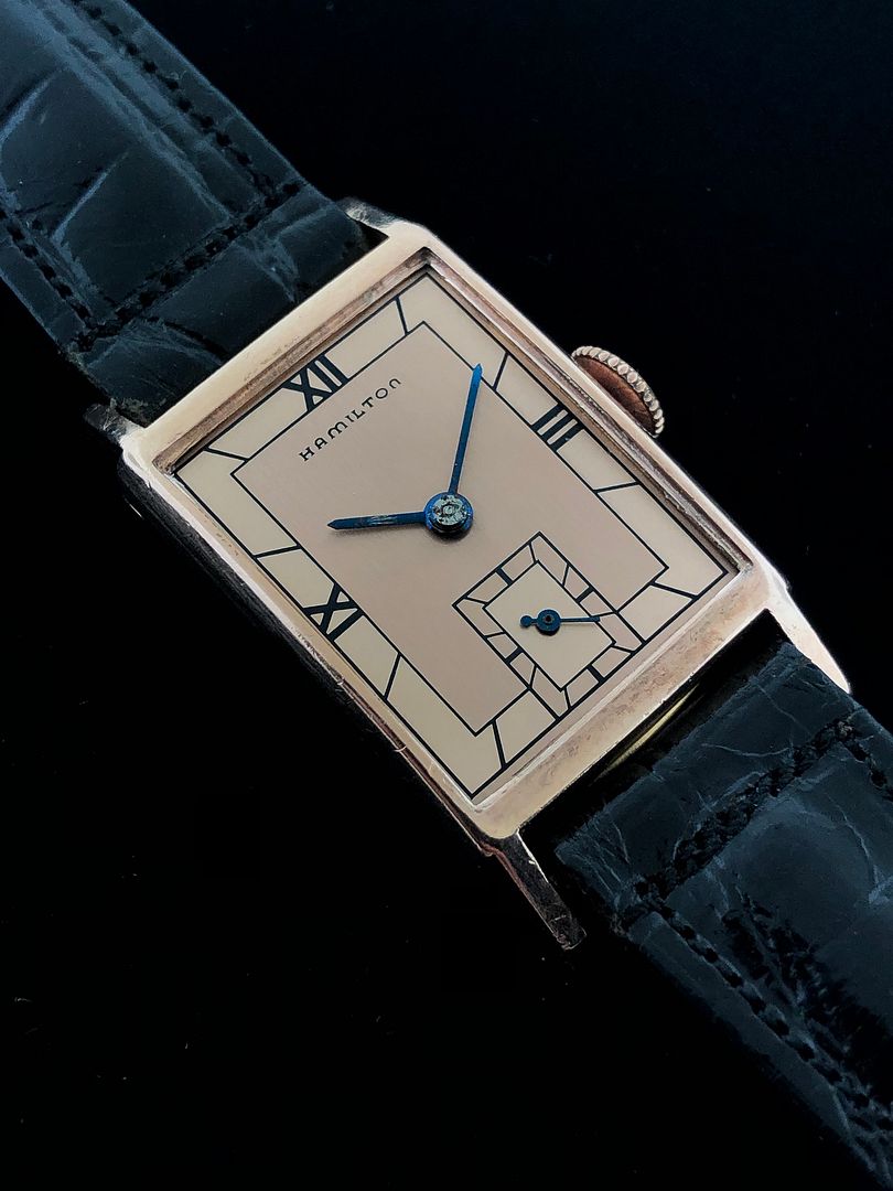

14K Coral Brock and dial. Dial refinished by L&S in 7 days. Two tone and looks perfect. It's a hard enamel dial done in two tone finish.
They did an exploding numeral cushion form for me, I think they used the wrong print as the numerals look too large and not exactly as Hamilton did it.
I will take back and see how he does a second time next time I go up. They are very nice easy to work with and the turn around is spectular.
It will be a learning curve and I will keep you informed of which ones they can do and which ones don't look good.

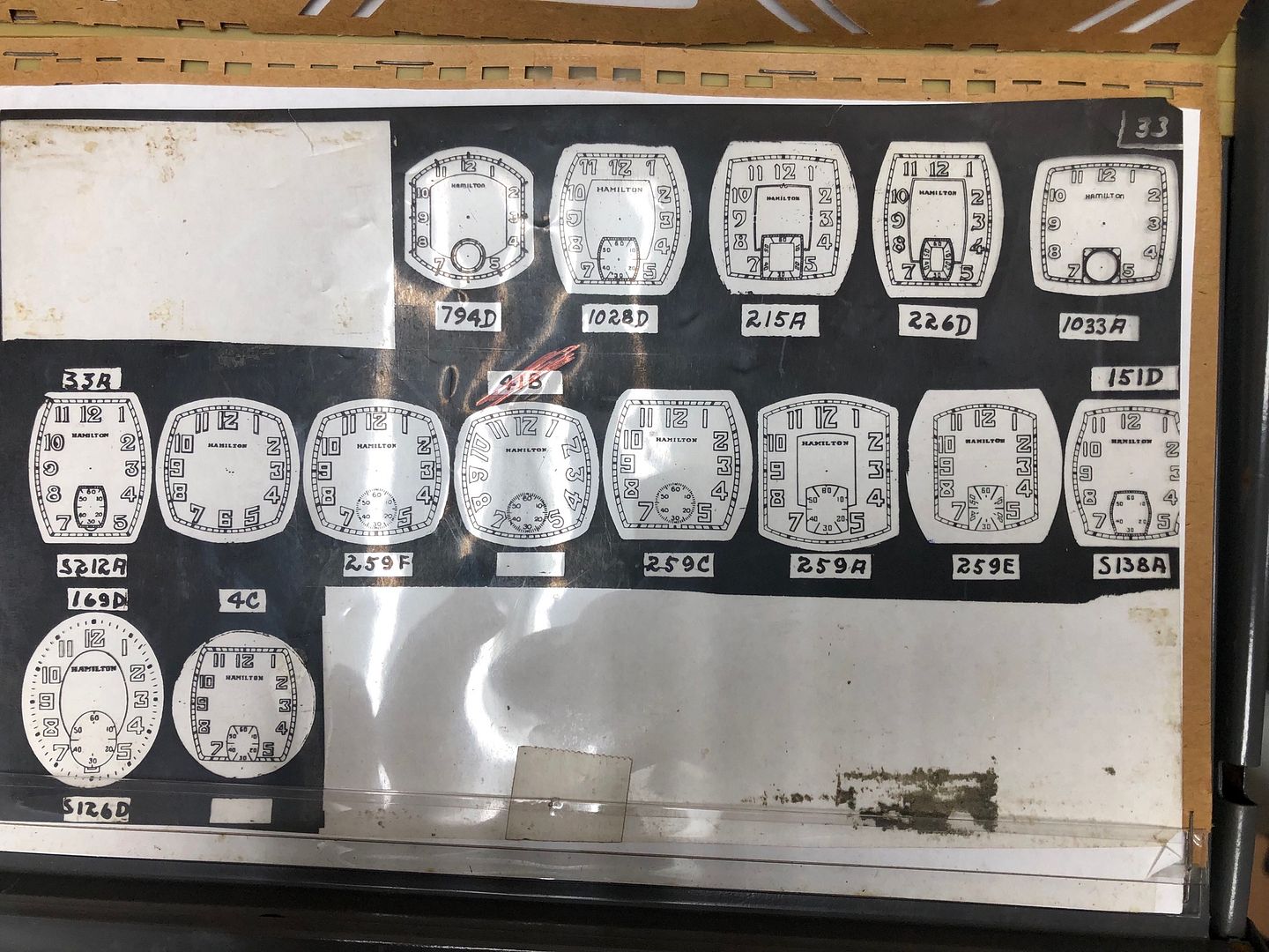

This is how easy L&S was last week. I took back the cushion with exploding numerals. They showed me their die plates, it’s right there (41-B) but they said they can’t find the die. So I took the correct dial with me and they will make a die in around 5 days. They send them out to be made, so it’s much faster than them making one.
I told them I would like to take photos of their dies/plates so we can send in our dials and say it’s S213b I need. Just a thought. I sent in my Dixon dial and it was
done incorrectly. So he said bring it back and I will be re-do it for free. The plate is there, but he accidently picked wrong one. He told me he has most every Hamilton plate as he bought out a company from Chicago and has thousands of dies. He showed them to me.

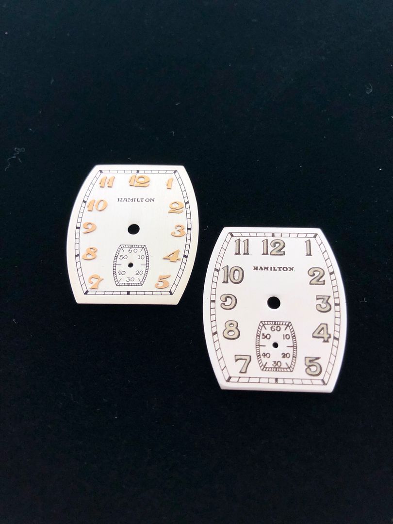

Look ar die 33R, a Perry notice below the sub seconds chapter, it has the partial 6 which is original to the dial as I have some nos dials. This die/plate has the correct print. International does not have this as their Perry refinshed dials are missing this.
You can see the two refinished ones by International, they use the agn style for both Perry’s when the luminous dial should have the partial 6 while the agn does not. Just no attention to detail. For years I just accepted it, but I prefer them to be correct. I think ID has only a few dies that are not correct. Most their work is good, just slow or not at all. I will keep you informed about L&S. Wonderful people.
